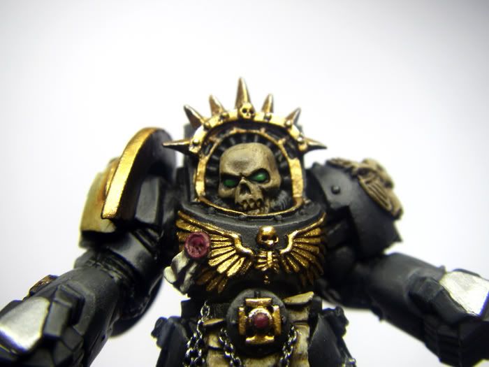

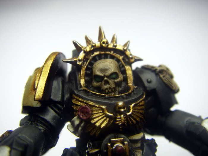

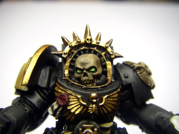

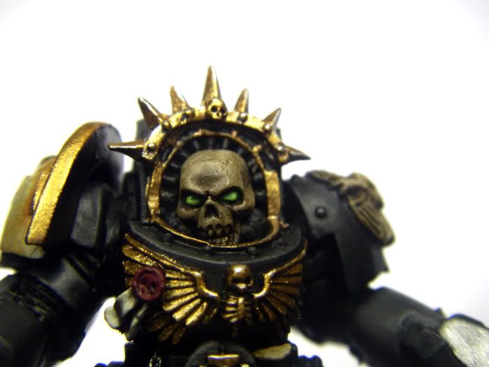

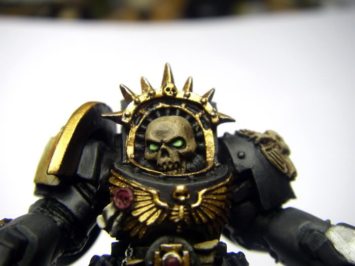

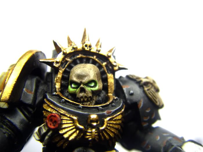

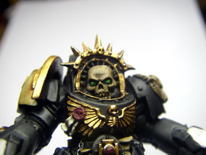

Now the lens is finished, time for the glow! It is easier to get the glow right than the lens itself in my opinion, so don’t worry, if you managed the lens this will be nothing to worry about. I start by painting a thin line of scorpion green around the light source, remember that some areas will not be hit by the light (like in this case, or any other space marine helmet, above the eye lenses, since there is a small rim protruding there which hinders the light to cover that area, same goes for this skull helmet, the “eyebrows�? prevents the light from reaching his forehead but there is nothing stopping the light from reaching his chins). The darkest colour used here is Scorpion green, don’t worry to much about blending it nicely, I’ve discovered that simply painting a thin line around the lens works well, but of course, if you are good at blending go ahead. Finish by highlighting the edges closest to the light source on your Scorpion green line with Livery green and you’re done! Sometimes I go one step further though by adding a tiny bit of skull white to the areas that are very close to the light source (I did on this chaplain). Easy!
(Note that some stronger Skull White was added to the eyes)
http://i63.photobucket.com/albums/h153/SupremeGrandMaster/tutorials/Eyeglow-scorpionandliverygreenlight.jpg
http://i63.photobucket.com/albums/h153/SupremeGrandMaster/Marines/TerminatorChaplainIMGP1994.jpg
Good Luck! Comments and criticism is much appreciated!

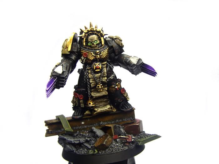

really awesome dude everything looks great and i do wanna know how did you paint theese lightning claws? awesome stuff ;)
