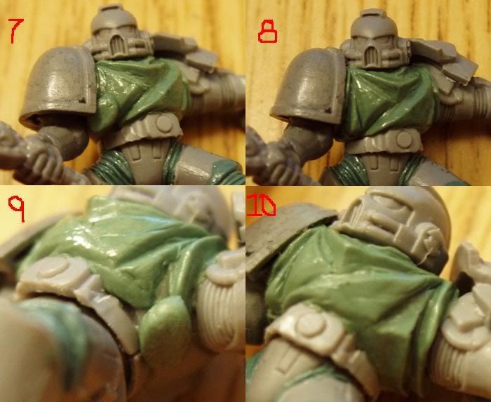

7&9. Add GS balls to places without GS yet....
* Don't apply too much GS at one time... Be patient and take your time...
8&10. Flatten and spread the GS with your sculpting tool and blend it with the GS on the model already... Add more folds... If you dont have the arms on, keep the GS out of the area where the arms go on.. It's the round raised part on the side if you didn't know... If you have the arms glued, then make sure the GS gets as close to the armpits as possible...
* Drag the tool to blend it with surrounding GS
